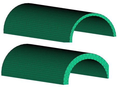

Figure 1:Thickness change of a curved face
