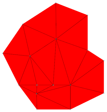

    stitched edge
    Notice how the largest adjacent triangle has been split into two smaller elements in the process.

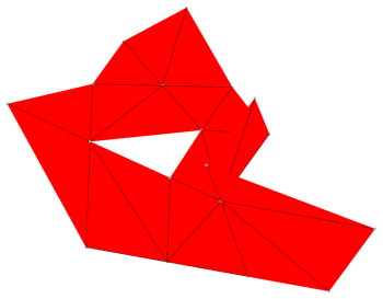

  11. Click Mesh tab > Entity Navigator)and select T14997 from the drop-down box. Rotate the model until it looks similar to the image below.
    missing element
    It is not appropriate to stitch this triangle. Instead you could use the Fill Hole or Create Triangles as you did in an earlier task. You will use Create Triangles in this instance.

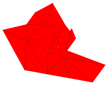

  14. Select the three corner nodes of the hole. The element is added to the model automatically.
    new triangle
