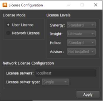

The License Configuration tool can be accessed from the Windows Start menu, located in the Autodesk Moldflow Insight folder.
Named User License configuration
Named user License configuration
Once you activate the License Configuration tool, select the License Mode you wish to apply.
With the Named User license, the default licenses are:
  • Synergy Standard
  • Insight Ultimate
Click Apply to accept your Named User License setup and close the License Configuration tool.
Important: Both Synergy and Insight need unrestricted access to .api.autodesk.com. Starting with the 2023 Named User license, make sure to add .api.autodesk.com to your firewall exception list, or you may find yourself blocked when you try to sign in.
