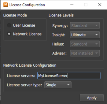

The License Configuration tool can be accessed from the Windows Start menu, located in the Autodesk Moldflow Insight folder.
| Network License configuration |

To activate the Network License
- Select the Network License in the License Mode section.
- Choose the License level depending on your purchased license.
- In the Network License Configuration section, enter the license server name (or IP address)
- Define the license server type. Options include Single, Redundant, and Distributed.
- Click Apply to accept the settings and close the dialog.
Note: Take care when entering the server name and license level - the License Configuration tool does not check for errors.
