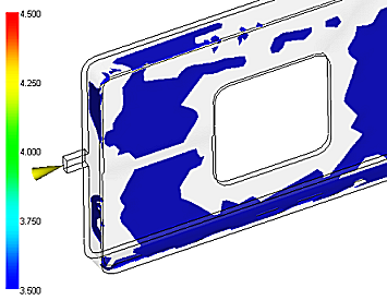

Areas with insufficient node layers can be located by using either a cutting plane or filtering the plot to display the middle node layer value.

Filtering the plot
With the Node layer number result active, right-click on the result name and select Properties. Select the Scaling tab. Click Specified and define the range of layers to be viewed. If the middle layer value expected is 4, filter between 3.5 and 4.5. Ensure the Extended color check-box is not selected.
Areas of the model with less than the required number of layers will appear as gaps in the result.
Because the node layer numbering starts at the edge of the part, it is normal for plate-like areas to have blank borders around the edge. This is a function of how the result is generated and may not be an indication of localized insufficient refinement.
