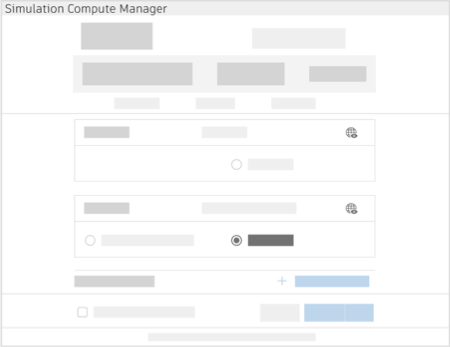

Autodesk Flex
When using Autodesk Flex, the default setting for solves is:
- Use Tokens
which consumes tokens on a pay-per-solve basis to minimize your cost.
Figure 1. Pay-per-solve option in the Simulation Compute Manager Analyze dialog
Note: If you plan to run many analyses, you may want to switch to pay-per-day with the Use Moldflow Insight 20XX option.
