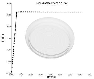

To review the Press displacement: XY plot:
  1. Click Press displacement:XY Plot in the Study Tasks list.
    press displacement
    The Press displacement:XY Plot result shows the distance the press moved, measured from the reference (initial) location, to the final location at the end of the compression phase, when the mold-cavity space has been reduced (compressed), displayed on an XY plot of distance versus process time.
    • Because the mold open stage is not considered in this analysis, there is no backward movement of the press. The minimum value of press displacement is zero and the maximum value is the press open distance. When the press displacement reaches the maximum value, the press will not move forward any more. It will remain stationary until the end of the process. The calculated press open distance is 26.5 mm while the one reported in the result is 26.26 mm which are close.
    • The objective is to run a compression molding analysis that generates a press displacement result that is equal (or as close as possible) to the value you specified as input for the press open distance. When these values are equal, the thickness of the molded part will be the same as the specified design thickness.
    • If the press displacement result is not close enough to the press open distance, you can adjust the input, re-run the analysis, and re-examine the results.
