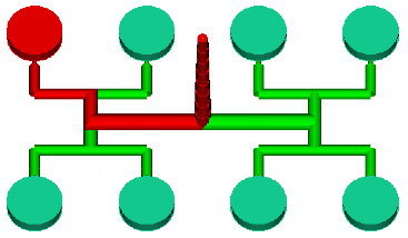

The figure below shows a naturally balanced 8-cavity tool. Only the geometry shown in red must be modeled. The remaining cavities are accounted for by occurrence numbers.
Figure 1: Occurrence numbers in a naturally balanced 8-cavity tool
Occurrence numbers in the figure above are defined as follows:
- The sprue is unique and therefore has an occurrence number of 1.
- The primary runner has an occurrence of 2 because the flow path splits in 2 at the base of the sprue.
- The secondary runners have an occurrence of 4, and the remaining part of the flow path has an occurrence of 8.

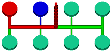

Before you consider modeling simple parts using occurrence numbers, it is helpful to understand the concept of symmetrical flow paths. Flow paths are said to be symmetrical when the physical geometry of the flow path is symmetrical and when the volume of plastic flowing through the paths are identical.
The figure below shows an artificially balanced 8-cavity tool. This runner system contains two distinct flow paths-respectively represented in red and blue-therefore the occurrence numbers differ from the first example.
Figure 2: Occurrence numbers in an artificially balanced 8-cavity tool
Occurrence numbers for the figure above are defined as follows:
- The sprue-in red-is unique and therefore has an occurrence number of 1.
- The primary runner-in red-has an occurrence of 2 because the flow path splits in 2 at the base of the sprue.
- The secondary runners, gates and parts-represented in blue-have an occurrence of 4.
