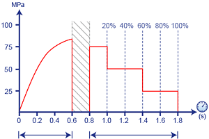

The following graph and table show a relative gas profile where the gas injection is specified by the gas volume controller. The graph shows the change from filling profile to gas injection profile. There is a 0.2 s delay between the end of the polymer injection and the start of the gas injection. The percentage duration of the gas injection is shown above the graph.
Note: Gas injection profiles do not include the polymer injection profile or the delay between polymer injection and gas injection.
(0–0.6 s) Polymer injection profile, (0.8–1.8 s) Gas injection profile by gas volume control
The relative gas injection profile in the following table is shown in the above graph starting at 0.8 s and ending at 1.8 s.
| Gas injection time (%) | Gas volume (%) |
| 0 | 75 |
| 20 | 75 |
| 20 | 50 |
| 60 | 50 |
| 60 | 25 |
| 100 | 25 |
| 100 | 0 |
