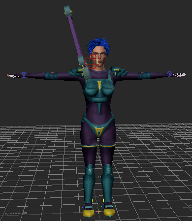

A model named Mia (mia_servo asset) appears in the Viewer window in the T-stance as shown in the following figure. This character includes a “Servo arm” that is parented to the right shoulder bone and added as a Character Extension.
Mia in the T-stance, with a Servo arm
