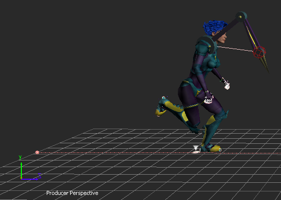

Go to frame 11.
Notice Mia's left foot is flat on the ground.
Mia at frame 11

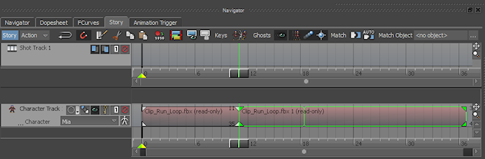

In the Story window Character Track, select the Clip_Run_Loop.fbx clip.
In the Viewer window, the clip's ghost vector is highlighted in green, indicating it is selected.
Go to the Story window controls.
Click the Razor button (
The Clip_Run_Loop.fbx clip is sliced in two at frame 11.
The second half of the original Clip_Run_Loop.fbx clip is highlighted in green indicating it is selected.

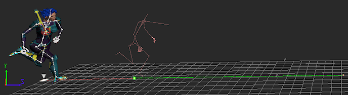

Go to frame 0.
Frame 0: Character's ghost and clip ghost vectors displayed in the Viewer wiindow

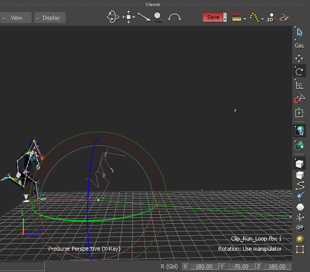

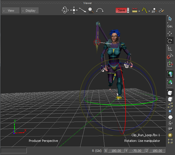

In the Viewer window toolbar, click the Rotate tool (
) (or click the Viewer window and press R).

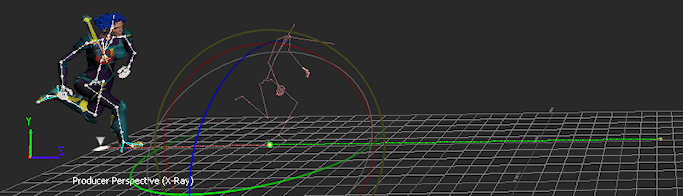

Rotation rings appear at one end of the selected clip vector ghost, as shown in the following figure.
Rotation rings at second ghost clip vector’s In point
At the bottom right of the Viewer window, in the Global/Local Reference fields, set the Y Rotation value to -70.
Note:You can manually rotate the clip vector by dragging the green (Y) rotation ring.
The clip vector turns slightly towards the right.

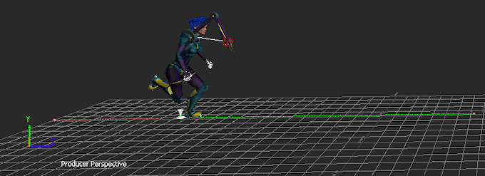

(Optional) In the Viewer window, use the tools in the Camera View Navigation toolbar (
), to get a better view of Mia's trajectory.
Mia at frame 11 shown in Normal Display mode and at a different angle
In the Action Timeline, J-drag jog through frames 8 to 16 slowly.
Mia turns as she runs, but her foot jumps slightly at frame 11. You need to blend the clips to remove the jump.
