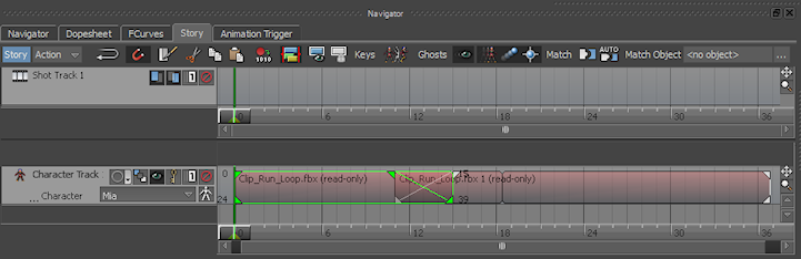

In the Story window Character Track, double-click the first clip.
The Asset Settings dialog displays the Character Clip settings and options.
In the Character Clip Out field, set a value of 15.
The first clip overlaps the second clip, creating a cross-blend.

Play the animation.
- In the Action Timeline, J-drag jog through frames 8 to 16 slowly.
There is no longer a jump at frame 11.
