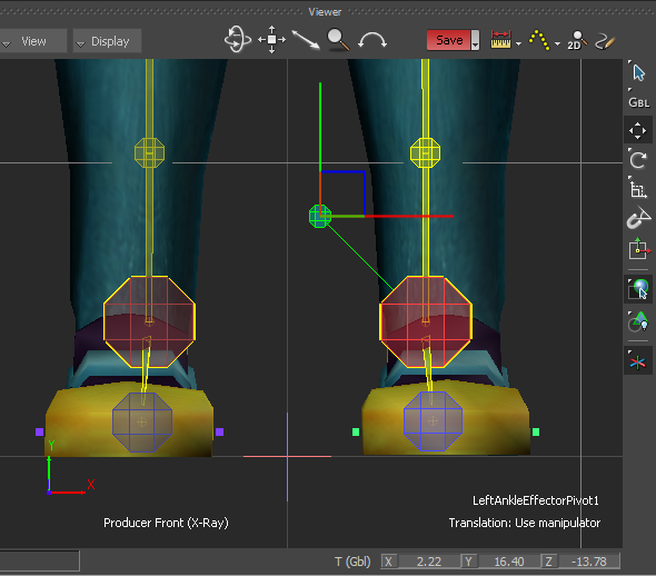

  1. In the Viewer window, click the View menu.
  2. Choose Orthographic Producer Front (or click the Viewer window and press Ctrl-F).
  3. In the Viewer window, zoom out ( or Ctrl-drag) and pan ( or Shift-drag) to see Mia’s feet.

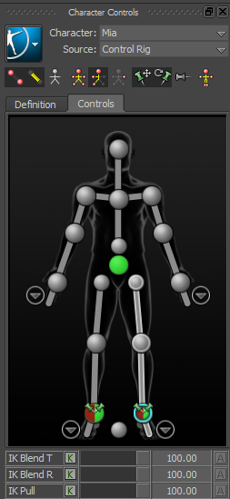

  4. In the Character Controls window, click the Left Ankle Effector.
    The selected effector is displayed with a blue ( ) contour.
  5. Right-click the Left Ankle Effector.
  6. Choose Create Aux Pivot from the context menu.
    The Auxiliary pivot is displayed in the Viewer window as a green sphere (by default).
    Note:
    You can change the display of the Auxiliary Pivot by editing its properties in the Resources window Properties tab.
    In the Character Controls window, the Auxiliary pivot is displayed on the left ankle cell as an X.
    When you create an Auxiliary pivot, the effector is deselected as shown in the following figure and the Pivot Object mode tool () is automatically selected.
  7. Translate the Auxiliary pivot to the tip of Mia's toes as shown in the following figures.

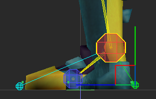

    • In the Viewer window, click the View menu and choose Orthographic Producer Right.
    • Pan ( or Shift-drag) and zoom in ( or Ctrl-drag) on Mia’s left foot.
    • Drag the Auxiliary pivot's Transformation handles to position the Auxiliary pivot at the tip of Mia's toes.
    • Switch camera view and position the Auxiliary pivot as shown in the following figure.

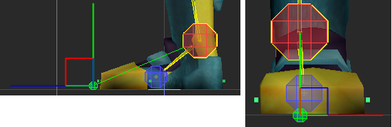

  9. Translate the Auxiliary pivot to the heel of Mia's foot as shown in the following figures.
    • If required, pan ( or Shift-drag) and zoom in ( or Ctrl-drag) on Mia’s left foot.
    • Drag the Auxiliary pivot's Transformation handles to position the Auxiliary pivot as shown in the following figure.
