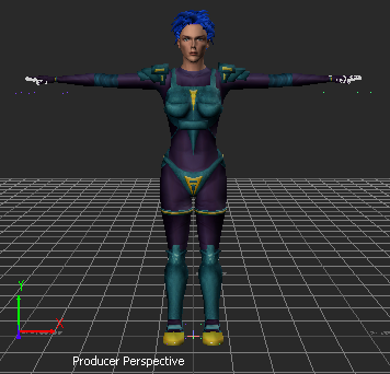

    In the Viewer window, a model named Mia appears in the T-stance.
    Mia in the T-stance
