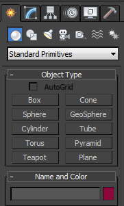

), select Reset.The scene and settings are cleared and the Create (
) panel displays the Geometry (
) standard primitives object type options.
Create panel standard primitive object type

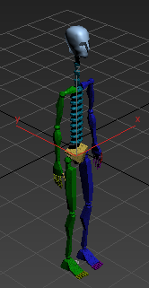

In the perspective viewport, click and drag to create a biped object.
Note:The size of the biped is not important.
3ds Max biped object

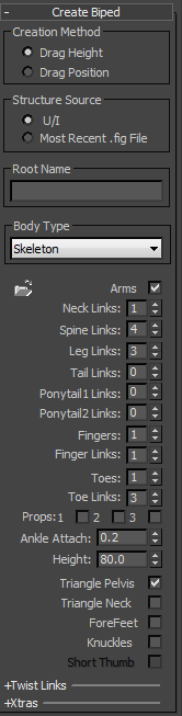

With Bip001 still selected, in the Skeleton Body Type options, make the following changes:
- set the number of Neck Links to 4
- set the number of Spine Links to 10
- set the number of Fingers to 5
- set the number of Finger Links to 3
- set the number of Toes to 5

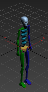

- set the number of Toe Links to 3, and press Enter.
The 3ds Max biped object has 4 neck links, 10 spine links, 5 fingers and toes, and 3 finger and toe links.
3ds Max biped object modified

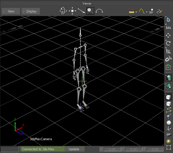

Send as New Scene.The 3ds Max scene (biped and camera) loads into MotionBuilder.
3ds Max biped displayed in the Viewer window
The established connection between 3ds Max and MotionBuilder is indicated in Viewer window status bar (
).If required, position your cursor anywhere in the Viewer window and press A to frame all of the biped.
