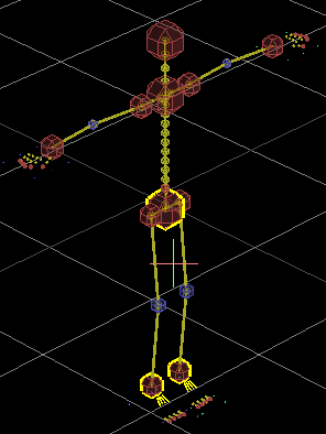

    The Control Rig is created and its effectors are shown on the biped in the Viewer window.
    3ds Max biped is characterized and rigged
    In the Character Controls window, the Control Rig settings are activated and include all the effectors you need to animate the Control rig.
    The Character representation is an image of a human form meant to represent the biped skeleton.
    Your biped is now rigged and ready to be animated.

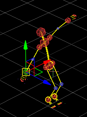

  6. In the Character Controls window, on the Character representation, select the Right Wrist effector.
    Character representation Right Wrist effector selected
    An effector that is selected is displayed with a blue ( ) contour.
  7. In the Viewer window toolbar to the right, click the Translate tool () or click in the Viewer window and press T.
    The transformation handles appear.
  8. Save your work.
  9. Translate (move) the hand down as shown in the following figure.
    3ds Max biped body follows the hand movement
    Notice as you move the hand, the arm extends and the rest of the body follows in a natural movement.
