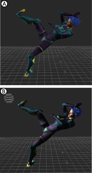

When you add a light, it is a Point light by default and the Global (ambient) light is extinguished. For example, the following figure shows the scene illuminated using the default Global light (A) and an added Point light (B).
Default and added lights A. Global light B. Added Point light
