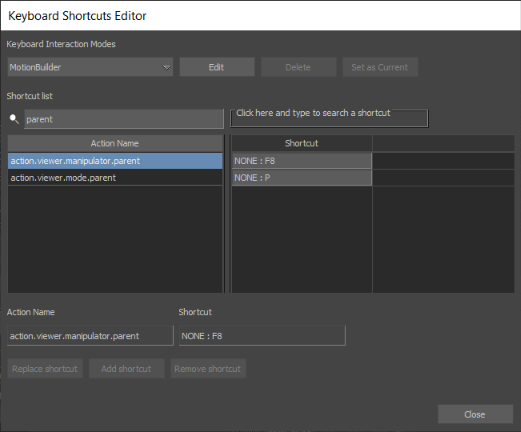

To open the Keyboard Shortcuts Editor
  • Select Main Menu > Python Tools > Keyboard Shortcuts Editor
Setting the Interaction Mode to use mouse and keyboard shortcuts from other 3D applications while working in MotionBuilder enables you to seamlessly switch between those applications and MotionBuilder without having to learn a new set of keyboard shortcuts. See Interaction Mode.
Note:
MotionBuilder is the default keyboard shortcut.
The Keyboard Shortcuts Editor
