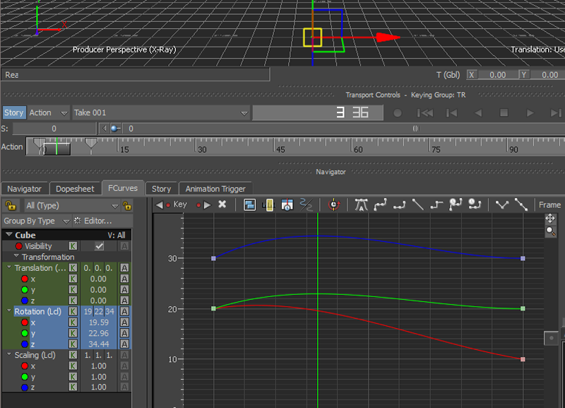

Creating Animation
Run the create_animation_on_cube.py script in the Python Editor to get a simple FCurve.
Following are the points to keep in mind:
  • KeyAdd() – Adds a key with an assigned value in an assigned time.
  • SetCandidate() – Changes the value in the current time but does not key it, until KeyCandidate() is executed.
  • KeyCandidate() – Adds the key with the candidate value in the current time.

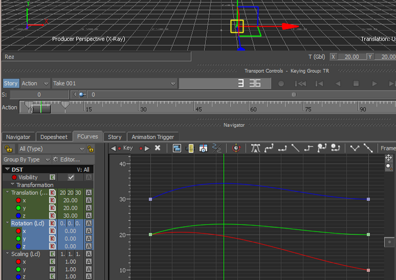

Copying Animation
Keep the last scene open, and then run the copy_animation.py script to copy the animation from the Cube and create a new cube called DST.
  • FBFindModelByLabelName() – Finds a model by name.
  • lDstNode.FCurve.KeyReplaceBy(lSrcNode.FCurve) – Replaces the keys in the destination FCurve with the source FCurve.
  • FCurves like x, y, z are stored in FCurveNode. These are for translation, rotation, and scaling.

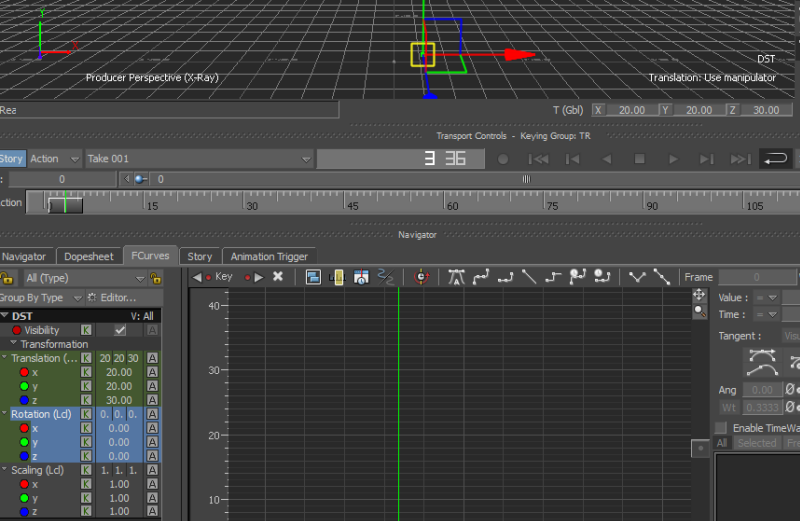

Clearing Animation
Keep the last scene open, select the DST object, and run the clear_animation.py script to clear the selected animation.
  • pNode.FCurve.EditClear() – Clears all the keys in the FCurve.
  • FBGetSelectedModels() – Gets all the selected models.
