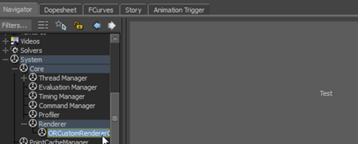

  • Asset Settings – You can control the asset settings panel for the renderer by subclassing FBRendererCallbackLayout. The asset settings panel appears when you select the custom renderer in the Renderer menu, or when you double-click the custom renderer option that is listed in the Navigator tab under System Core Renderer as shown in the following figure.
![](../images/asset.png)
You can design your own asset settings panel for the custom renderer.

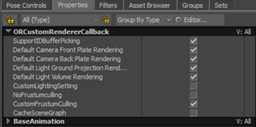

  • Property View – You can access the renderer properties through the property view as shown in the following figure.
![](../images/props.png)
The property view changes to display the renderers properties when you select the renderer from the Renderer menu.

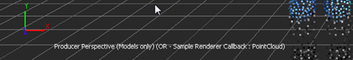

Additionally, the camera title is expanded to include the custom renderer name and its current preset setting, if selected. The following figure shows how the renderer and preset are displayed alongside the camera title in the viewport.
