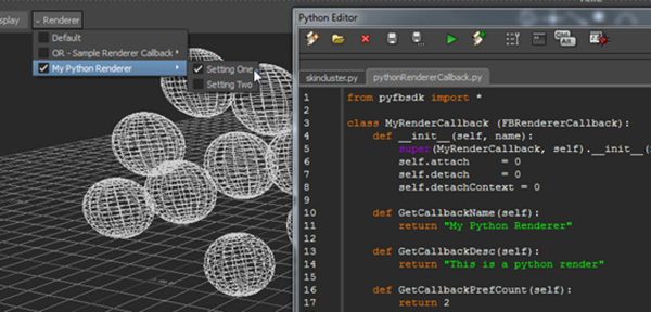

Using Python to Implement a Custom Renderer
The following Python script demonstrates how you can use Python to implement a custom renderer:

Although, this script looks trivial from a production perspective at first, but it actually indicates how to achieve greater flexibility. You can choose to use the PyOpenGL Python package to implement a more useful rendering. You can also implement the performance demanding routines in C++ first and then expose them in Python. You can eventually use them inside this Python based custom renderer. In this way, the flexibility of Python and efficiency of C++ can be utilized. The following figure shows the Python implementation of the custom renderer.
