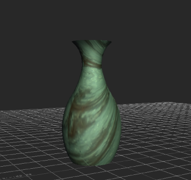

Vase with materials, textures, and shaders added
A model’s material properties may be used by the texture settings when applying textures, and by the shader settings when applying certain shaders.
Materials and textures
Attach textures or Layered textures to a Material’s properties. For example, you can attach a texture to the Material’s Diffuse property to add color and detail to the model’s surface. See Adding a texture to a material and Detaching textures.
For other Material properties, the attached texture can only display in the Viewer when a type of shader is applied to the model. For example, to see the texture attached to the Normal Map property, apply a Bump Map shader and add a light to the scene.
Materials and shaders
The results of some material settings applied to a model may not display in the Viewer window. You must use shaders with advanced Material settings to see the results in the Viewer window. The advanced settings that need shaders are as follows:
