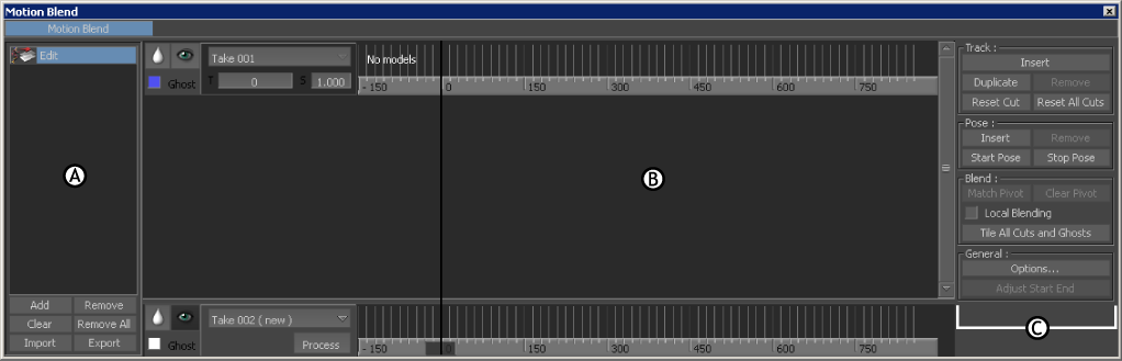

To display the Motion Blend window, select Window > Motion Blend in the menu bar.
Motion Blend window A. Edits pane B. Track list C. Motion Blend Options pane
When you open the Motion Blend window, an edit containing a single track set to Take 001 is automatically added. The track contains no models, sensors, or Control rigs, as indicated by the “No models” text in the first track of the Track list.
The Motion Blend window does not support shapes or morph targets. You can only blend translation, rotation, and scaling.
The Motion Blend window consists of the following:
  • Edits Pane
  • Track list
  • Motion Blend Options pane
  • Blend Editor
