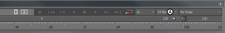

  • In the Transport Controls, select one of the options in the Time Format field.
    Transport Controls A. Time Format field
    The frame rate is selected in the Time Format field, and the unit of measurement is changed. See Time Format menu for more information.

Transport Controls *A.* A custom frame rate is selected
