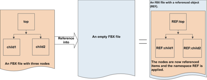

Any FBX file from MotionBuilder 2011 or latest can be referenced. You must store the entire referenced object within a namespace when referenced.
The namespace is a proper object. Namespaces are used for separating the referenced items from the scene items. When a file is referenced, it is represented as a reference object, which is a type of namespace. The following figure illustrates how a file is referenced.
