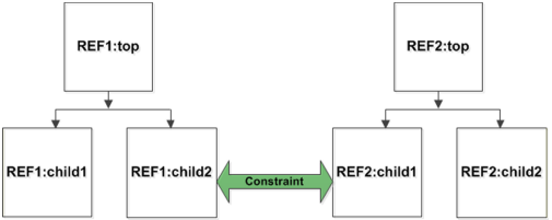

The following figures illustrate the connections that are allowed.
  • This figure shows an allowed constraint.
![](../images/connection1.png)

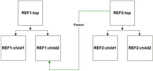

  • This figure shows an allowed parent connection.
![](../images/connection3.png)

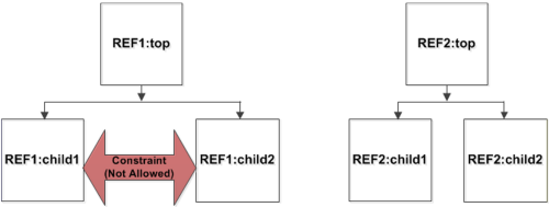

  • This figure shows a constraint that is not allowed.
![](../images/connection2.png)

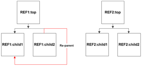

  • This figure shows a re-parent connection that is not allowed.
![](../images/connection4.png)

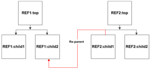

  • This figure shows another re-parent connection that is not allowed.
![](../images/connection5.png)
