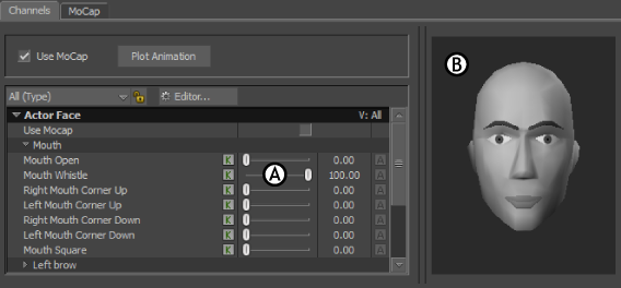

To view the effect of an individual channel on the model in the Channels pane, drag a channel slider fully to the right.
A. The channel slider for Mouth-Whistle is at 100%. B. The full value of the channel displays on the Preview model
When you blend generic channels, you can see the composite effect on the Preview model. In the Channels pane, drag multiple sliders to see the effect on the Preview model.
