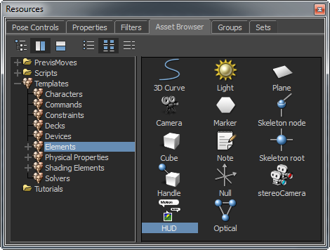

The HUD is available as an asset in the Asset Browser > Templates > Elements sub-directory.
You need to add the HUD asset in the Asset Browser to a camera or a scene. Only then, you can add a HUD element to the HUD asset and display the information in the element in the Viewer.
To add a HUD asset to the active camera or the scene:
  1. Drag the HUD asset from the Asset Browser to the Viewer window.
  2. From the context menu, select Add to Current Camera or Add to scene.

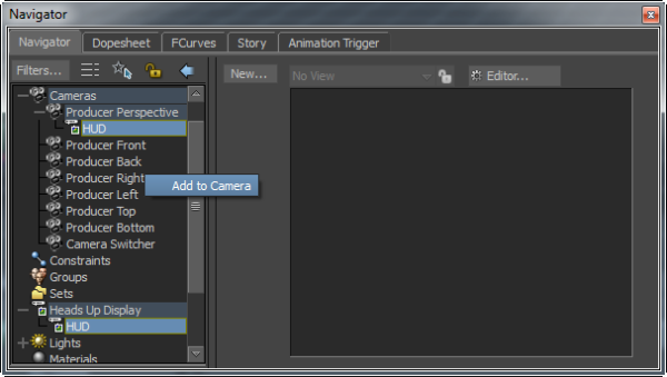

To add a HUD asset from the scene or a camera to another camera:
  1. Drag a HUD asset from the scene or a camera onto the desired camera.
  2. Click the Add to Camera context menu option.

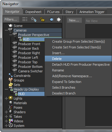

To delete a HUD asset from the scene or a camera:
  1. Right-click on the HUD asset in the scene or a camera.
  2. From the context menu, select Delete.
    If the HUD asset in a camera is a parent of another HUD asset in the scene and vice versa, then both the HUD assets are deleted.

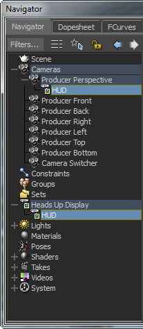

    Tip:
    Clicking a HUD asset, in the scene or in a camera, highlights its parent or child HUD asset. This helps to know whether a HUD asset that you want to delete is independent or attached to another HUD asset.

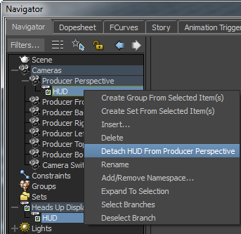

To detach a HUD asset from a camera:
  1. Right-click on the HUD asset in a camera.
  2. From the context menu, select Detach HUD From .
    The displays the name of the camera to which the HUD asset belongs.
    Selecting the Detach HUD From option detaches the HUD asset only from the camera, even though it contains a child HUD asset in the scene.
