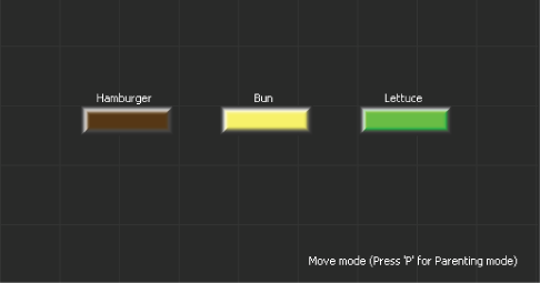

Nodes that represent models are light gray by default or they are the color of their material, as shown in the following graphic. Nodes that represent markers, nulls, camera interests, and skeleton roots are red by default.
Three models represented by nodes in the Schematic view.
