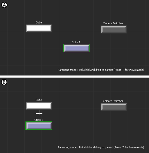

In the Viewer window:
Switch to Schematic view (Ctrl-W).
Press P to activate Parent mode.
Double-click the node representing the object you want to select as a child. To add additional objects to the selection, Ctrl-click the corresponding nodes.
Drag the selection to the parent object’s node.
A dotted line joins a parent and its selected child objects, and the parent object is highlighted. The parent is connected to the selected children, and the objects are rearranged in a hierarchy.
For example, the following figure illustrates two cubes before and after parenting in the Schematic view.
A. Before parenting B. After parenting, Cube 1 is the child of Cube.
