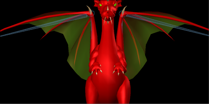

Character Extensions are particularly useful with character models that have atypical features (such as the character with wings and a tail in the following figure) because they let you easily include the added features with your character’s Full Body keying group.
A dragon character with wing and tail Character Extensions.

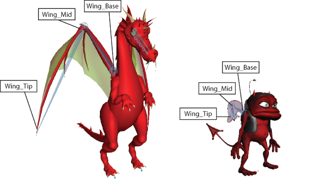

Copying animation between two Character Extensions
If you have two characters with equivalent Character Extensions, you can copy keyframe animation from Extension to Extension. To create an equivalent set up on the source and target Character Extensions, both Extensions need to have the same Extension Label, and the corresponding objects within the Extensions need to have the same Labels.
Two Character Extensions set up for copying animation
