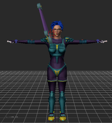

  4. In the Asset browser display pane, click the mia_fk_runstopturn asset (mia_fk_runstopturn.fbx file) and drag the asset in the Viewer window.
    The FBX Open context menu displays.
  5. Select FBX Open All Takes.
    In the Viewer window, a model named Mia – with a “Servo arm” Character Extension – appears to be running.
  6. From the menu bar, choose File Save As.
