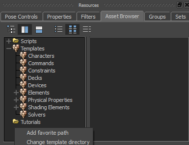

To add a favorite path to the Asset Browser pane:
In the Resources window, make sure the Asset Browser tab is selected.
In the Asset Browser, right-click the Asset Browser pane.
A context menu displays.
Click Add favorite path from the context menu.
In the Open directory window, navigate to the directory you would like to add in the Asset Browser.
Click the directory and then click OK.
The directory is added to the Asset Browser pane in numeric alpha order.
