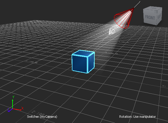

Example: Adding Objects to the Scene
Sample Viewport Output:
Program Summary: The following program presents a broad overview of how to add various objects to the scene, including cameras, lights, materials, shaders, i/o devices, and constraints.

# Output.                                                     #
Scene graph:
Scene - FBModel
    myCube - FBModel
        myLight - FBLight
    myCamera - FBCamera
Scene contents by type:
Materials
    DefaultMaterial: FBMaterial
    myMaterial: FBMaterial
Shaders
    Default Shader: FBShaderLighted
    myShader: FBShader
Cameras
    Producer Perspective: FBCamera
    Producer Front: FBCamera
    Producer Back: FBCamera
    Producer Right: FBCamera
    Producer Left: FBCamera
    Producer Top: FBCamera
    Producer Bottom: FBCamera
    myCamera: FBCamera
Lights
    myLight: FBLight
Devices
    myKeyboard: FBDevice
Constraints
    Shot Track: FBStoryTrack
    myConstraintRelation: FBConstraintRelation
