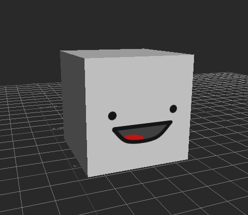

Example: Applying a Texture to a Model
Sample Viewport Output:
Texture File and Location: C:\<user>\Documents\MB\Face.png
Program Summary: The program below creates a cube model, and creates a texture from the 'Face.png' file contained in the current user's My Documents folder. It then associates the texture to a new material's diffuse channel, and appends the material to the model.
