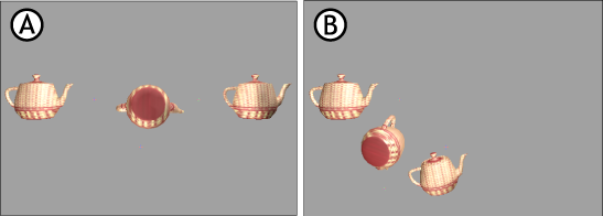

Two way
A collision with either parent or child object affects the other. The collision reaction is spread through every connection.
In the following image, all objects in the chain are affected when the objects are set to Two Way propagation.
Two-way propagation A. Collision with second object B. Collision with third object

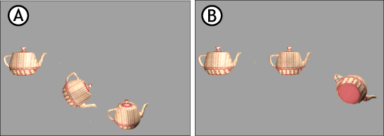

Parent-to-child
The Parent-to-Child relationship creates a one-way collision where the parent object affects the child object, but a collision with the child object does not affect the parent object.
The following image shows the result when an object is clicked in a chain where all objects are set to Parent-to-Child Propagation. In A, a collision is triggered with the second object, the effect of which influences its child, the third object. In B, a collision occurs with the third object, but it has no child to which it can pass its reaction, so only the third object is affected.
Parent-to-child A. Collision with second object B. Collision with third object

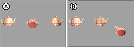

Child-to-Parent
The Child-to-Parent relationship creates a one-way collision where the child object affects the parent object, but a collision with the parent object does not affect the child object.
The following image shows the result when an object is clicked in a chain where all objects are set to Child-to-Parent Propagation. In A, a collision occurs with the second object where it cannot pass its reaction to the first object, its parent, because it is set to passive. In this case, only the object that has the collision is affected. In B, a collision occurs with the third object that is passed to its parent, the second object.
Child-to-Parent A. Collision with second object B. Collision with third object
