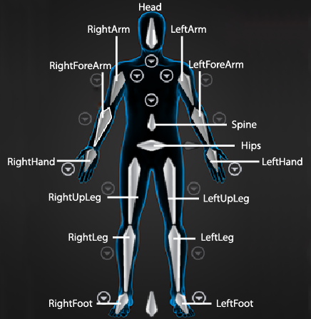

Required nodes
The fifteen nodes required by the HIK solver display in the full-body layout of the Character view, and are grouped together in the Required group of the Name Match view.
These required nodes identify the main joints in the skeleton of your character: its ankles, knees, hips, spine base, shoulders, elbows, wrists and head. Figuring out which bone in your skeleton map to each of these nodes is straightforward:
NodeMaps to
HipsThe bone that is the parent of spine and leg chains in your character.
LeftUpLeg and RightUpLegThe first bones in upper legs of your character.
LeftLeg and RightLegThe first bones in lower legs of your character.
LeftFoot and RightFootThe first bones that extend from ankles of your character into its feet.
SpineThe first bone in the spine that is above the bone you map to the hips node. Represents the base of the spine.
LeftArm and RightArmThe first bones in upper arms of your character.
LeftForeArm and RightForeArmThe first bones in forearms of your character.
LeftHand and RightHandThe first bones that extend from wrists of your character into its hands.
HeadThe last full bone in spine of your character, not the tip of the head, but the last full bone in the neck chain. This is typically the bone that controls the skinning of the head.
