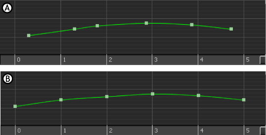

Plot On Frame
Turn on Activate Plot On Frame to resample the data based on the specified frame rate, and ensure that data is plotted on exact frames. Keyframes are set on each frame of the animation.
If your take does not start or end on an exact frame, samples are taken from the frame before the beginning or after the end of the take. Plotting starts and ends on the closest exact frame.

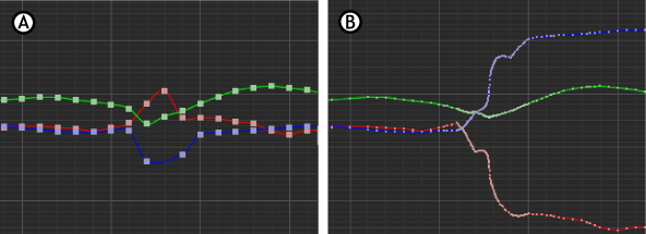

For example, in an animation curve displays before (A) and after (B) plotting when Plot On Frames was active. The Start time code is 0 and the End time code is 5. After plotting, the keyframes are set exactly on each frame in the animation.
Plot on Frames A. Original curve before plotting B. Curve after plotting with Plot on Frame

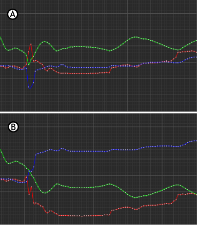

Unroll
Select the Unroll option to unroll equivalent Euler rotations, making the curves continuous.
Unroll A. Original curves B. Unroll applied

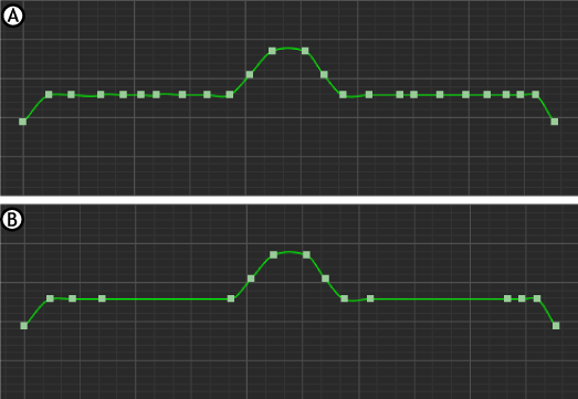

Constant Key Reducer
Reduces the number of keyframes by eliminating redundant keyframes. Reducing the number of keyframes reduces the file size. This filter is active by default.
For example, the following figure shows a function curve before (A) and after (B) the Constant Key Reducer filter is applied, reducing the number of redundant keyframes used by the function curve.
Constant key reducer A. Original curve B. Constant Key applied

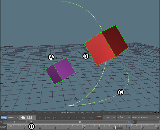

For example, Cube_source rotates to the left, then upwards. Its animation consists of three keyframes at frames 0, 30, and 60.
Cube1 is connected to Cube_source by a Parent-Child constraint, and moves beside Cube_source in two arc-like movements. No keyframes are set on Cube1, only on Cube_source.
Animation using a Parent-Child constraint A. Cube_source B. Cube1 C. Cube1’s curved animation trajectoryD. Keyframes set on Cube_source at frames 0, 30, and 60

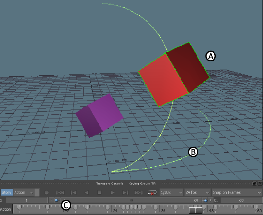

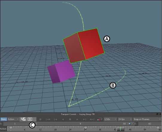

If you plot this animation using Smart Plot without Increase Fidelity, the keyframes at frame 0, 30, and 60 are plotted to both cubes, but the animation’s trajectory changes (see B in the following figure) because Cube1 needs more keyframes to retain its original animation.
Animation plotted without Increase Fidelity A. Cube1 B. Cube1 trajectory altered C. Three few keyframes plotted to Cube1

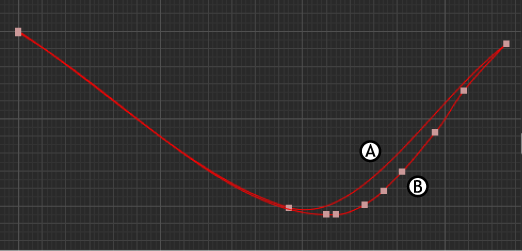

To determine the number of keyframes that are set, use the Fidelity Keys Tolerance field.
Lets you determine the plotted animation’s accuracy compared to its original animation. Depending on the field’s value, extra keyframes are set to duplicate the original animation.
The value in the Fidelity Keys Tolerance field is a unit of measurement which represents how far, or to what degree, the plotted animation diverges from the original animation. The lower the field’s value is, the more keyframes are set when plotting, correcting differences between the original animation and the plotted animation.

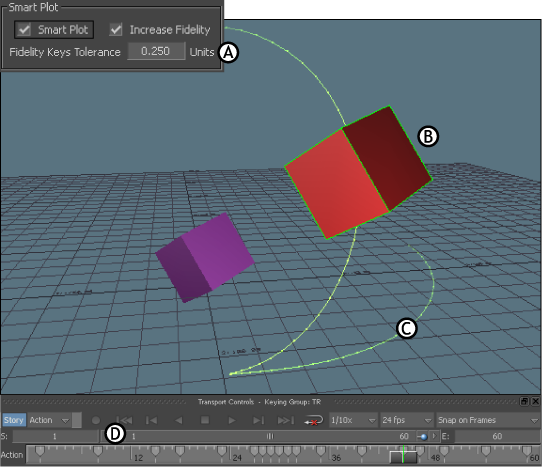

For example, in the following figure, the Fidelity Keys Tolerance field is set to 0.25, which is the default setting. Plotting sets many keyframes to Cube1, recreating the original animation path. However, you may not want so many keyframes.
Plotting A. Fidelity Keys Tolerance field B. Cube1 C. Cube1 trajectory similar to the original animation D. Keyframes plotted to Cube1 recreate original animation

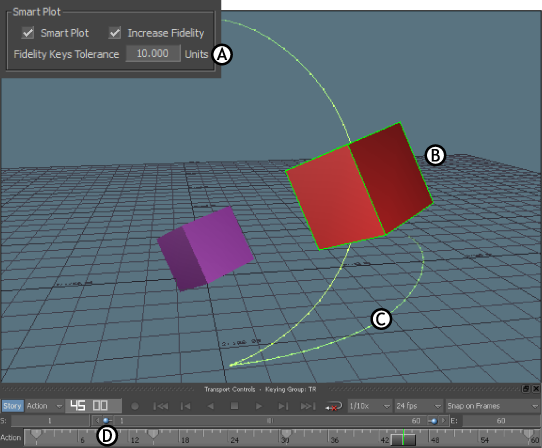

When the Fidelity Keys Tolerance field is set to a higher value, plotting sets fewer keyframes, but the animation path can change depending the number of keyframes.
Plotting A. Fidelity Keys Tolerance field B. Cube1 C. Cube1 trajectory different than the original animation D. Five keyframes plotted to Cube1
You can also use the FCurves window to compare the animation. For example, compare the X-axis Rotation function curves of the animation shown in the following figure A and B.
FCurves window A. Rotation function curve of Cube1 with Fidelity Keys Tolerance field set to default value (0.25)B. Rotation function curve of Cube1 with Fidelity Keys Tolerance field set to default value (10.0)
