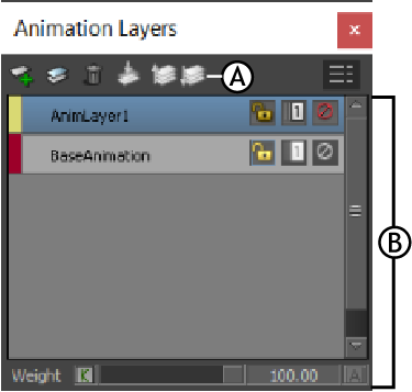

Create and blend multiple layers of animation in a scene using the Animation Layer editor.
You can create layers to organize keyframe animation, or to keyframe on top of animation without overwriting the original curves.
You can open the Animation Layer editor by selecting Window > Animation Layers from the main menu bar. See Accessing the Animation Layer editor.
Animation Layer editor A. Animation Layer toolbar B. Animation Layer pane
