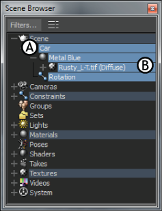

To save a model and all of its assets:
  1. Right-click the model in the Scene browser and choose Select Branch from the context menu.
    The model and its constraint are selected.
    Branch selected in the Scene browser A. Old Car model B. Old Car’s associated assets
  2. With the branch selected, select File > Save Selection.
    The saving procedure is identical to selecting File > Save As. See Saving assets to an .fbx file.
