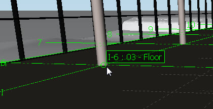

Identify a Grid Point
Hover the cursor over a grid intersection on your model. The name and/or reference of the levels will be displayed.
