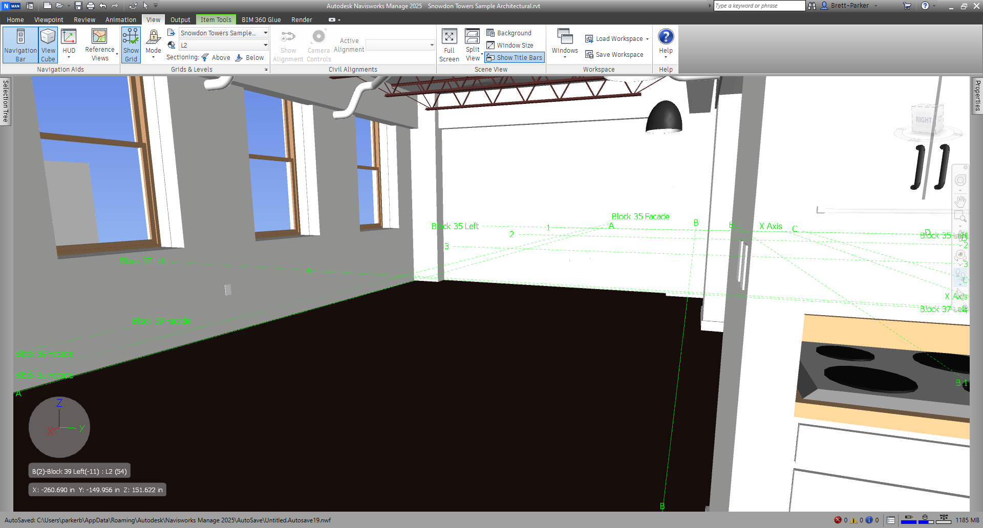

Grids and levels perspective camera projection

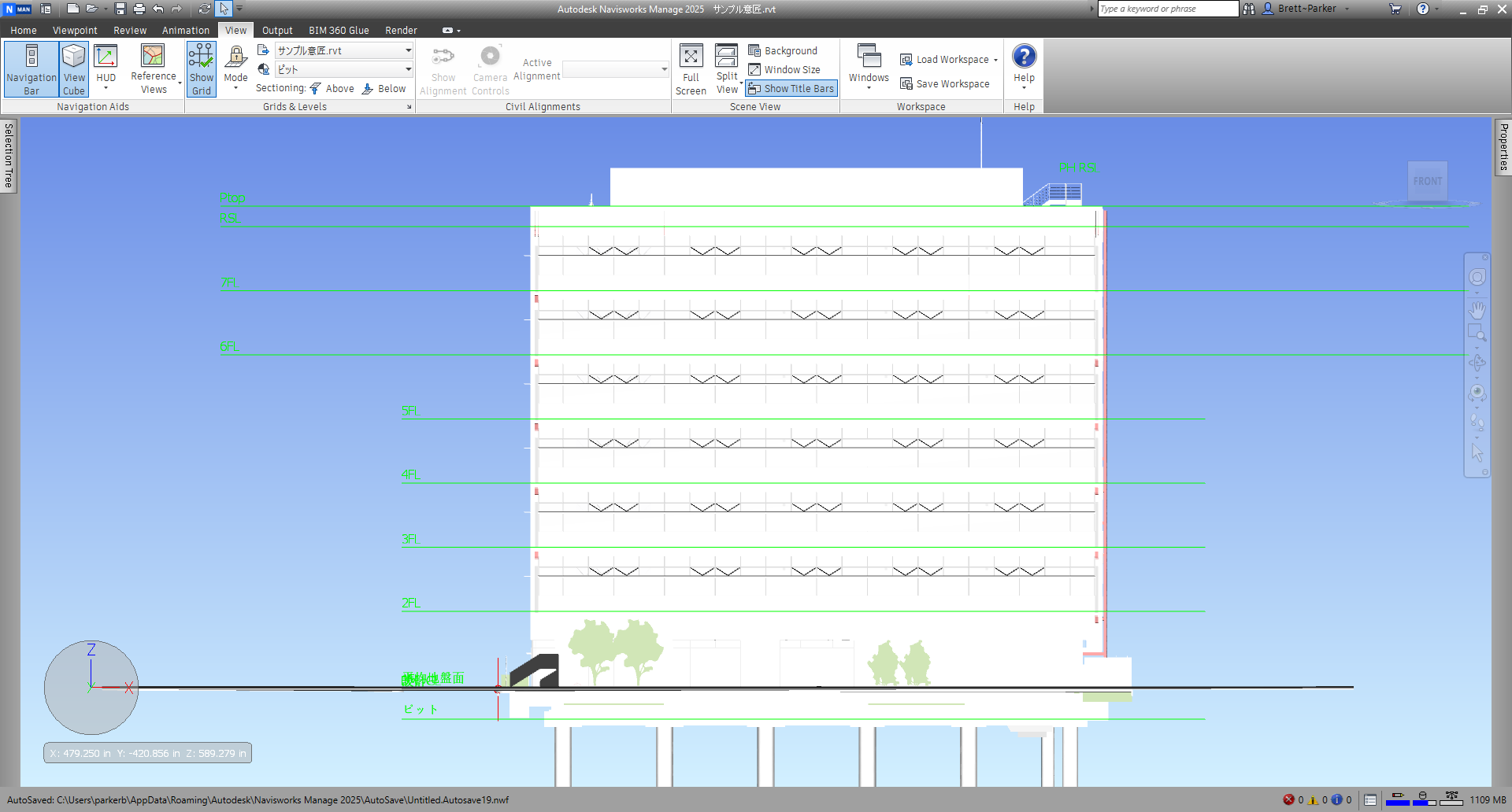

Grids and levels orthographic camera projection
