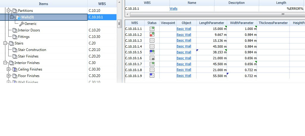

Status Notifications
When an item or group is changed, a colored triangle appears in the cell that has been changed, and an icon appears in the Status column. The following notifications appear in the Status column of the Quantification workbook.
Action | How Indicated | Icon | When Shown |
Override | Green light in Status column | ![]() | When a formula has been overridden and Change Analysis has not been run. Hover the icon to see a tooltip. |
Change | Blue light in Status column | ![]() | Where a model object has changed and differs from the associated takeoff item in Quantification Workbook. Hover the icon to see a tooltip. |
Error | Red light in Status column | ![]() | Where there are computation errors with the formula or model item. Hover the icon to see a tooltip. |
Delete | Black light in Status column | ![]() | Where a takeoff's model item has been deleted. Hover the icon to see a tooltip. |
Note: Any number of the above status notifications may appear in the Status column for one takeoff item.
