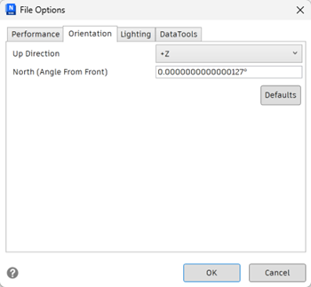

Change the World Orientation
Click Home tab > Project panel > File Options
.In the File Options dialog box > Orientation tab, enter the required values to adjust the model orientation.
Click OK.
