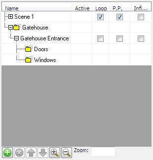

Organize Scene Components into Folders
  1. If the Animator window is not already open, click Animation tab > Create panel > Animator .
  2. To add a subfolder to a scene, right-click it, and click Add Folder on the context menu.
    To add a subfolder to a scene component, right-click it, and click Add Folder on the context menu.
  3. To move a subfolder, right-click it, and click Cut on the context menu. Right-click the new location, and click Paste on the context menu.
  4. To rename a folder, click it, and type a new name.
    Tip: Use names that can help you to identify your scene components in future.
