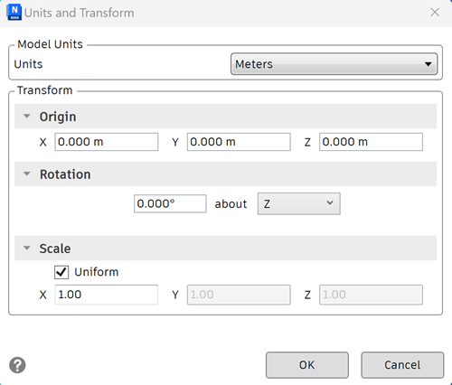

Change units in a loaded 3D model
Right-click the desired 3D model in the Selection Tree, and click Units and Transform on the context menu.
In the Units and Transform dialog box, select the required format in the Units drop-down list.
Click OK.
Change Units in a 2D Sheet
- Right-click the desired 2D sheet in the Scene View, and click Units and Transform on the context menu.
- In the Units and Transform dialog box, select the required format in the Units drop-down list.
- Click OK.
