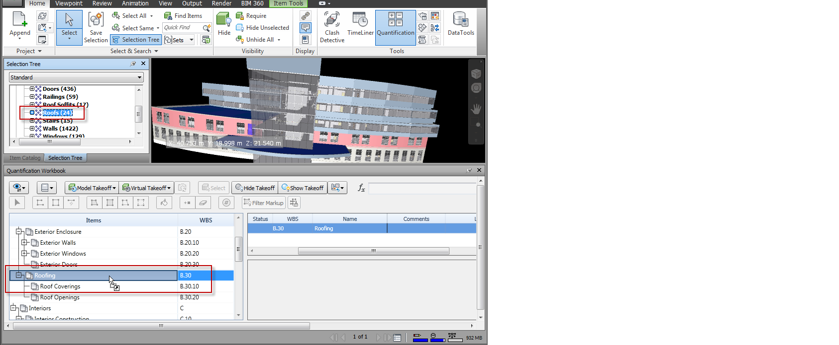

Efficient takeoff means you can drag and drop objects, groups, or a whole Selection Tree structure onto a workbook item, to generate a quick, accurate takeoff.

Model takeoff uses the properties embedded in the design source files to create takeoff data. It extracts the objects from the model and displays them as Items in the Quantification Workbook.
