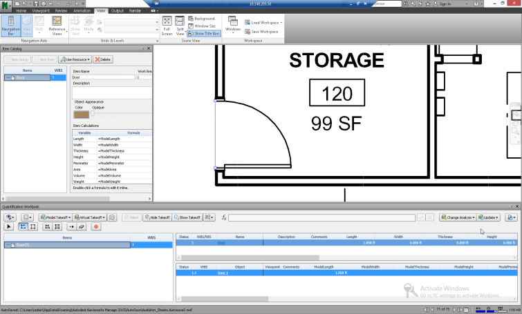

2D Takeoff allows you to measure lines, areas, and counts on a 2D sheet. Rather than carrying out manual calculations on paper sheets, you can markup geometry and perform accurate calculations. The geometry is then taken off automatically, to sit alongside the 3D takeoffs in your Quantification workbook.
2D Takeoff supports native and scanned DWF files, and non-native DWFs files such as PDF. See Supported file types.
2D Takeoff Workflow
Select or create an Item in the Items Catalog.
Open the 2D sheet you want to use. If your project contains several sheets or models, use the Sheet Browser to select a 2D sheet.
Select a Markup tool from the 2D Takeoff toolbar.
Draw your markup on the sheet.
Your Takeoff results appear in the Quantification workbook.
