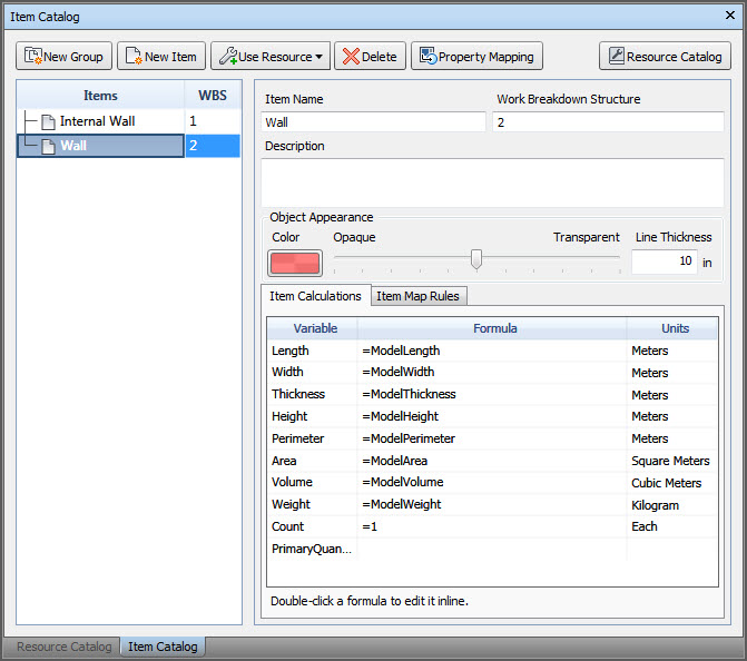

2D Takeoff tools allow you to mark up line geometry on a floor plan or other worksheet. The markup will then appear as an object in the Quantification workbook, displaying properties such as area, perimeter, or length. You can trace linear markups to measure a wall or the perimeter of a room, or use area tools to record the extent of a surface, such as a floorspace. You can also place markup pins on 2D sheets to perform a Count takeoff. Manage the appearance of takeoffs by changing the color, opacity, and varying the line thickness of takeoffs in the Item Catalog. Once you have finished drawing takeoffs, you can print the 2D sheets containing your markups using the print option in Navisworks.
