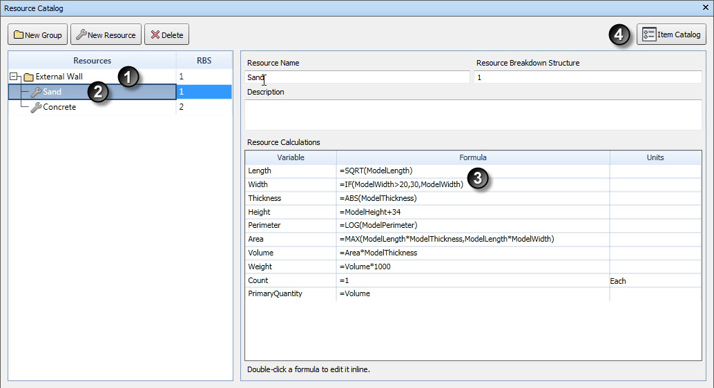

The Resource catalog is a database of your resources for a project. Resources could be related by function and type such as materials, equipment, or tools, and may include wall board, coverings, or structural components.
1. Resource Group.
2. Resource. You can group resources into folders and sub-folders.
3. Formula. Double click to edit.
4. Item catalog. Click to switch between Resource Catalog and Item Catalog.

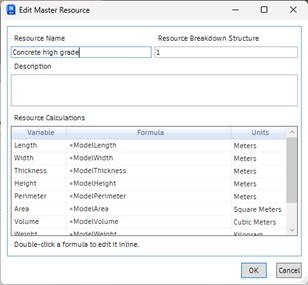

Master Resources
Master Resources are your original, baseline Resource values for your project catalog. You can make changes to Master Resources in the Item Catalog. Any changes you make are applied to new Resources only.
